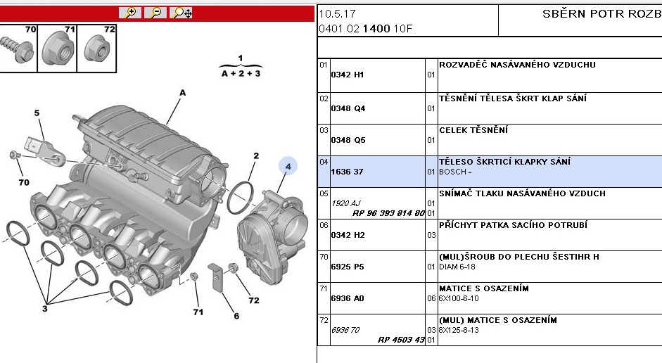

Okay, it looks like a drive-by-wire throttle body in the schematics. Maybe there is something wrong with the actuator. Did you verify the position of the butterfly by taking off the intake? I don't really know how to diagnose those as I'm working only on older cars and I do not have a shop (garage) background.
