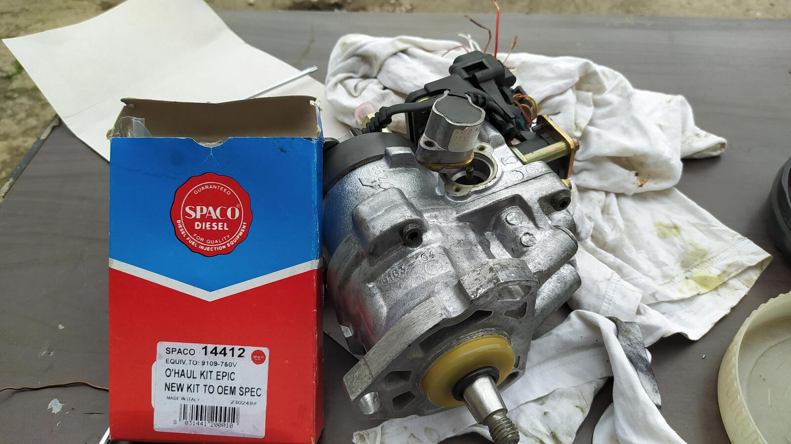

Lucas Epic, replacement of rubber on the pump.
..since last year the pump started leaking fuel, especially when the weather is cold, in the winter it leaked fuel the most, I bought a "Spaco -1441" set for sealing the Epic pump, so I solved that problem too.

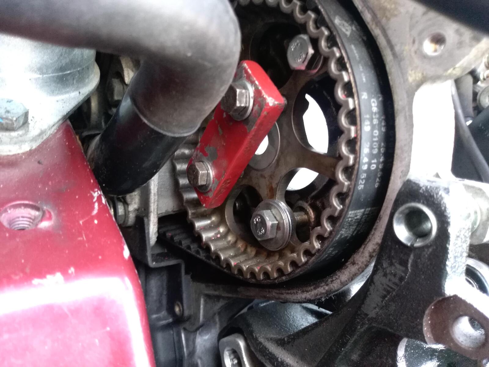

..we secure the pulley with two screws, so the belt doesn't need to be removed. This red tool is used to press the pump shaft off the pulley.
large.IMG_20250502_164347.jpg.63c64489583a3bca9d7e01c9f3a93cc8.jpglarge.IMG_20250502_131356.jpg.c98a62282821e4b93109d6d2b59538d0.jpglarge.IMG_20250502_131350.jpg.1540e370a4826ec949290ac441710e11.jpg

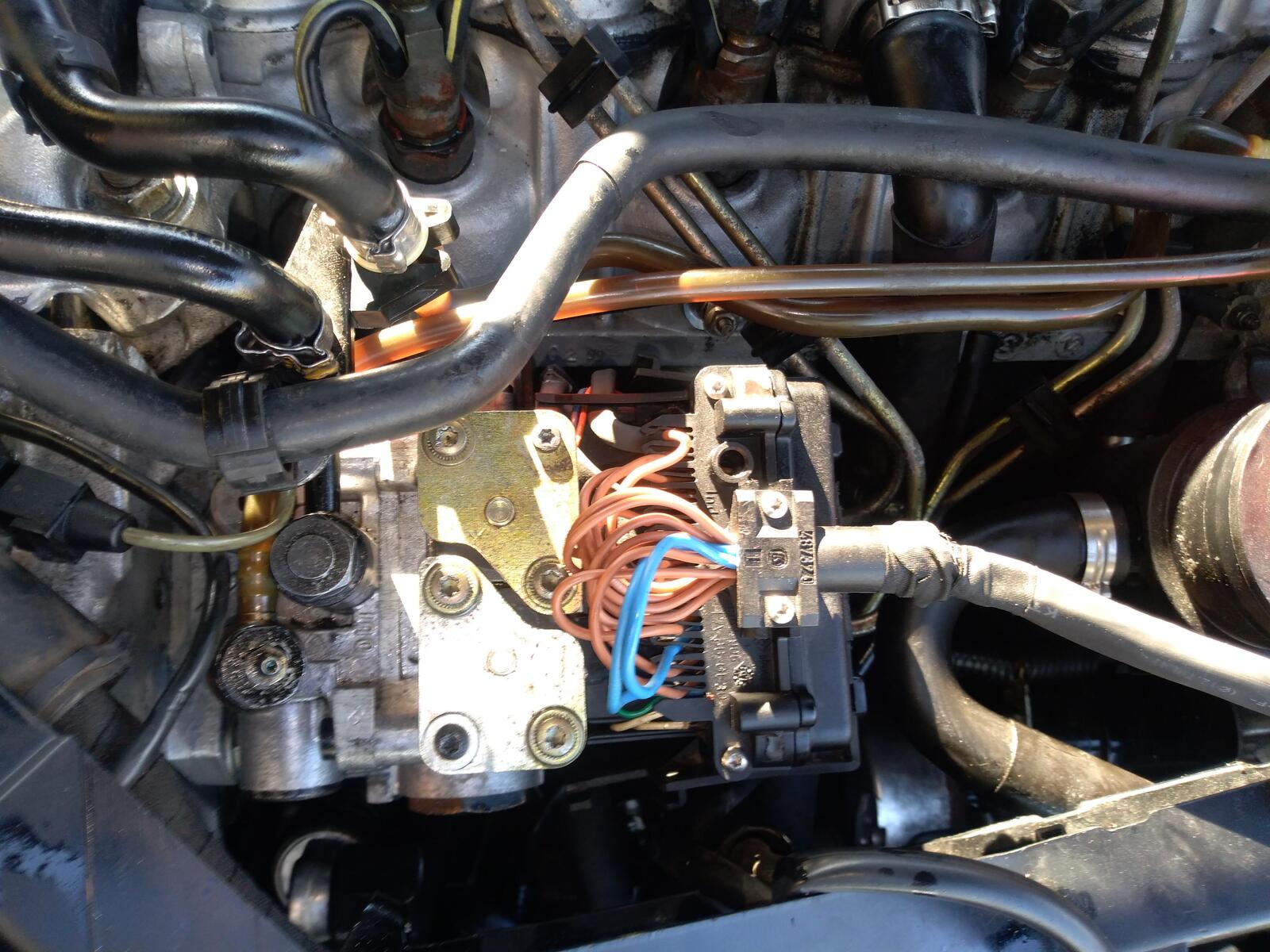

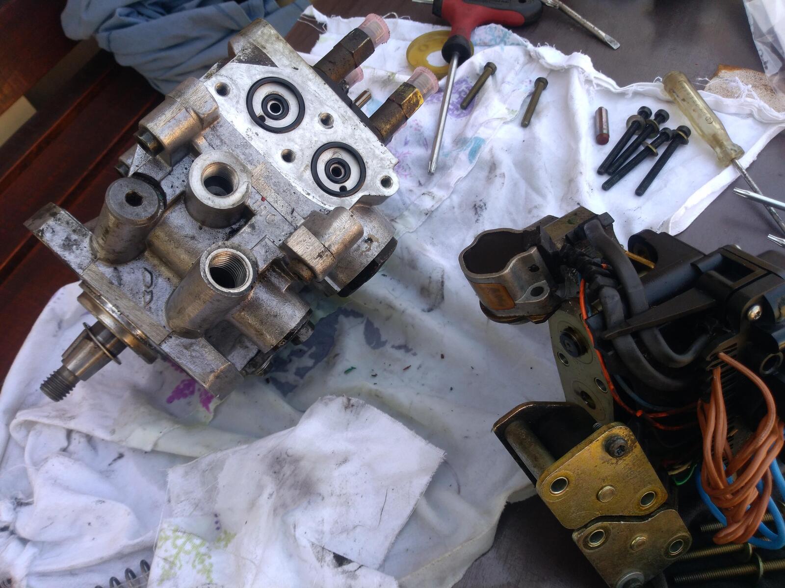

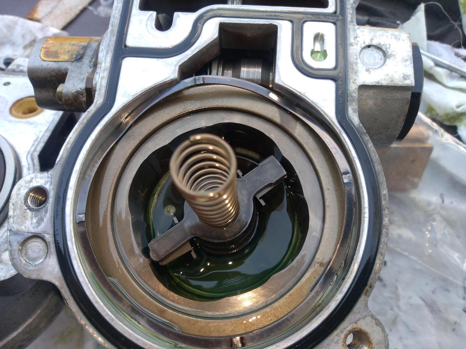

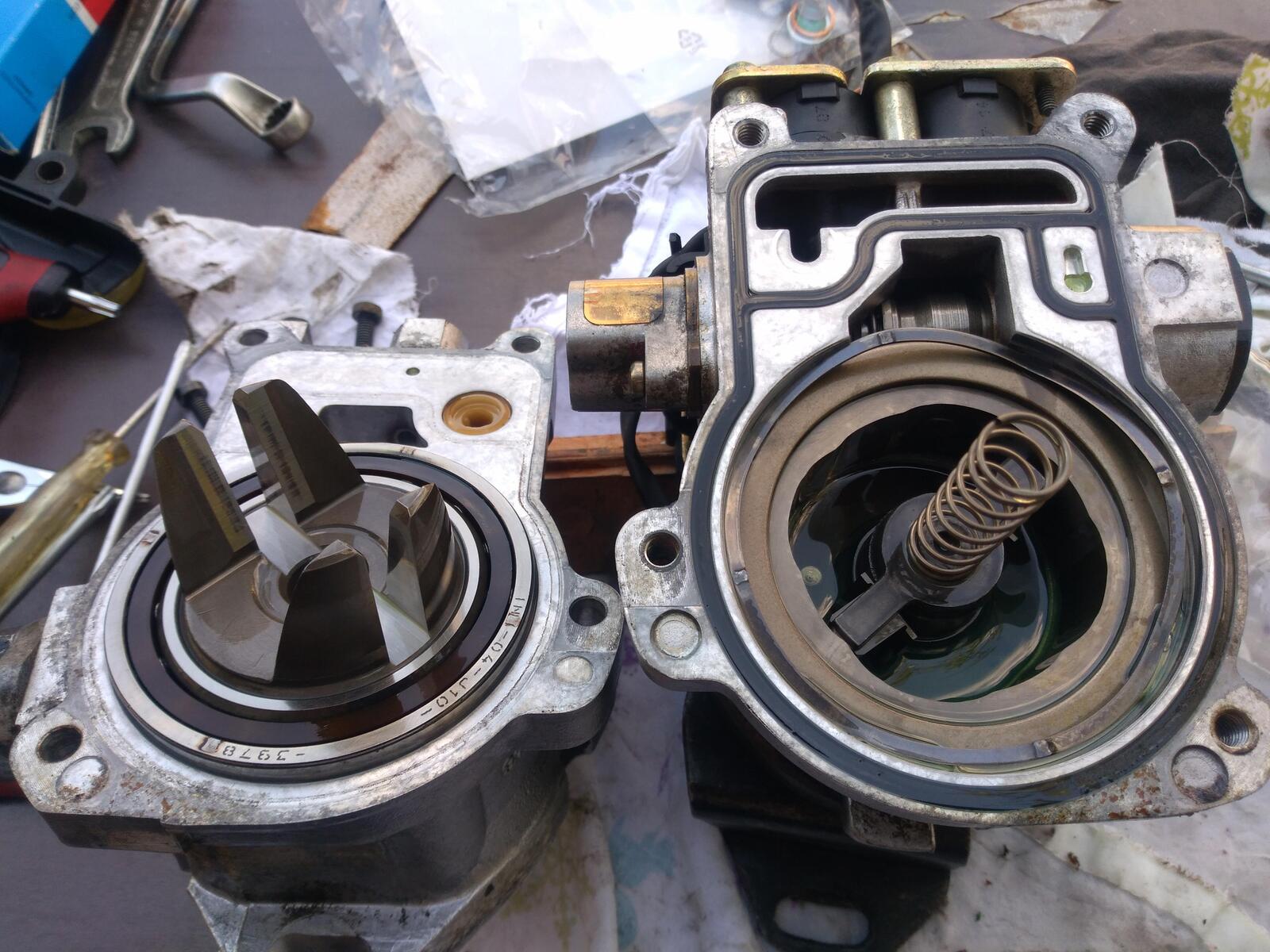

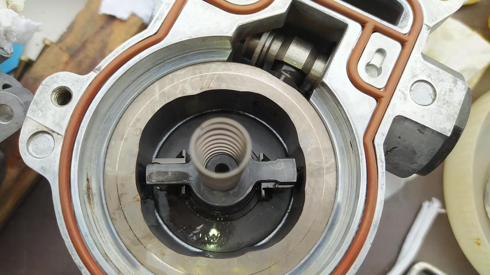

Since this is a pump with electronics, there aren't many complicated parts, in principle everything is easy to remove, replace the O-ring rubber, and put back in place.
large.IMG_20250502_131427.jpg.9a9ca76541fec0f5912fbd1ce514cb45.jpglarge.IMG_20250502_132148.jpg.b5ad23126204fcebbb92d0de35f1d5e3.jpglarge.1744912090528.jpg.664d5fd0d0cbcd1eea5593286de179c6.jpg
large.IMG_20250502_133513.jpg.c36858fccca599ed3c885b91676d8001.jpglarge.1744912090518.jpg.adb0a4003442d14f2606fc83b63dad8c.jpg

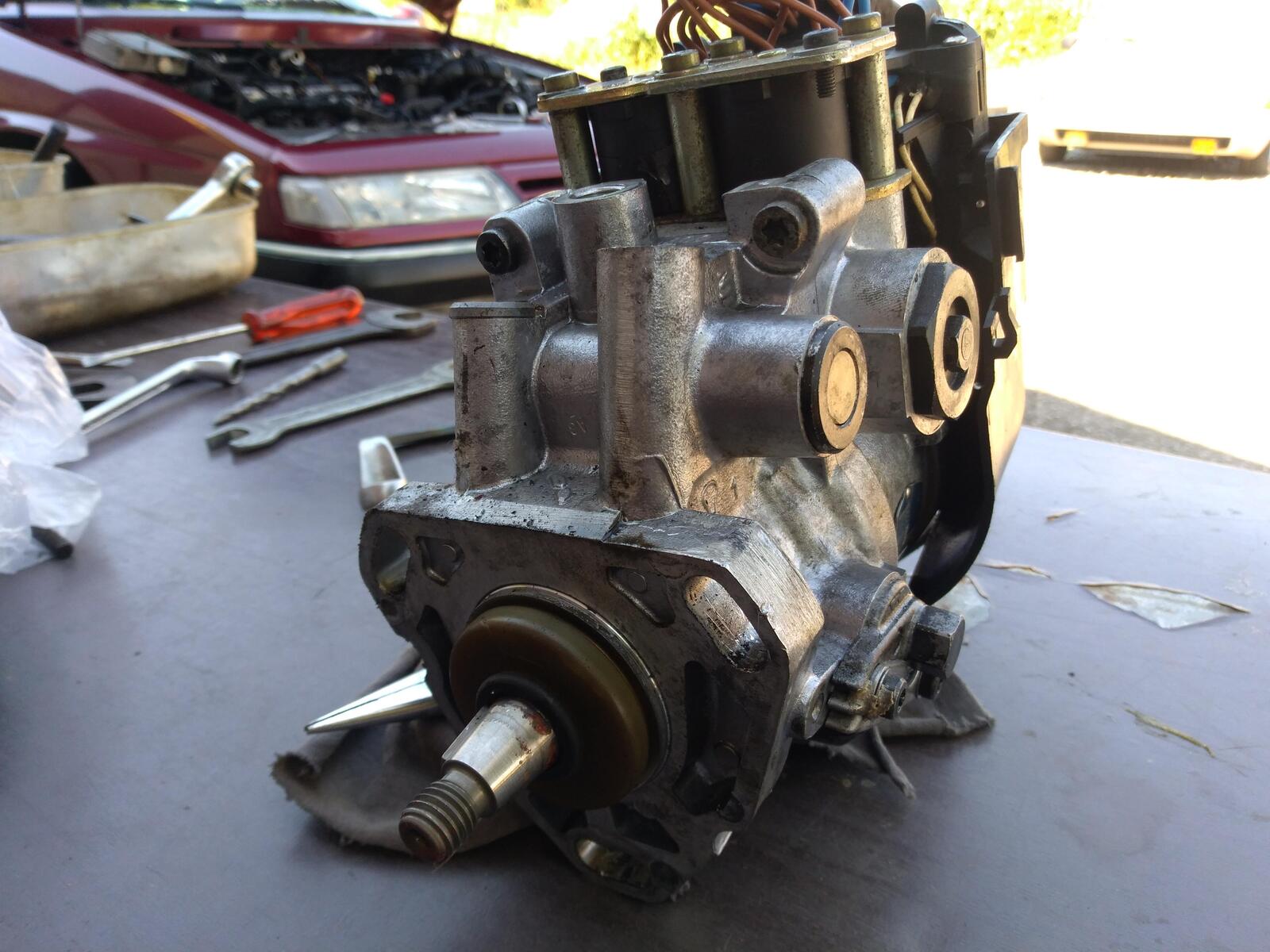

...in principle, this gasket, the rubber, is the one that most often leaks fuel.велика.1744912090375.jpg.a022a9a6ced7da71ad0fec28e7d2dd49.jpgвелика.IMG_20250502_135710.jpg.6bb5f2e764d9b396d11ac5b980076364.jpgвелика.IMG_20250502_135722.jpg.4a388c467cabdbecd172f304d3b628ae.jpgвелика.1744912090331.јпг.97дбф0аеф28192285дд1дф99ф2бц6аац.јпг
Bearbeitet ( von gasa)
...on the back of the pump, there are two large O-rings and one small O-ring. Everything is easy to disassemble and put back in place.large.1744912090312.jpg.d368b1ff1c0436194ec6aa111adaa330.jpglarge.1744912090296.jpg.1eb5b4fed715ec3cac70c5c4cc51edc5.jpg

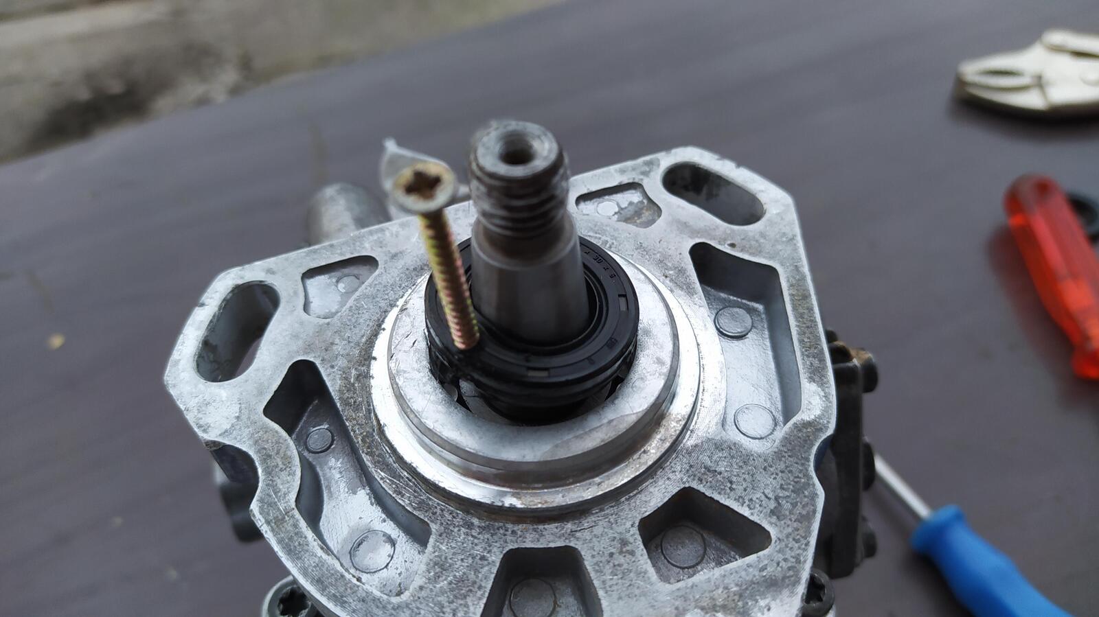

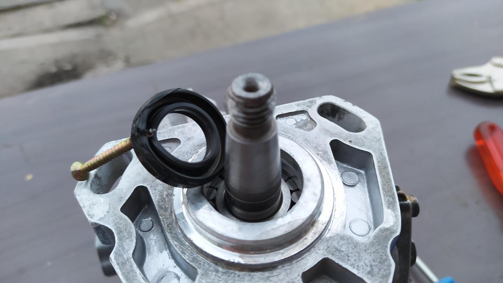

..at the end, the seal is replaced, first the screw is hammered into the seal with a hammer and then it needs a few threads to be screwed in and pulled out with pliers.
large.1744912090288.jpg.2a3ef2219d0578321ca426c971dd6c8e.jpglarge.1744912090280.jpg.bef1ee7fb2ddc3cb79e797bd83f8dee0.jpglarge.1744912090272.jpg.ed16e59d062d5f34d8b728932a555210.jpg

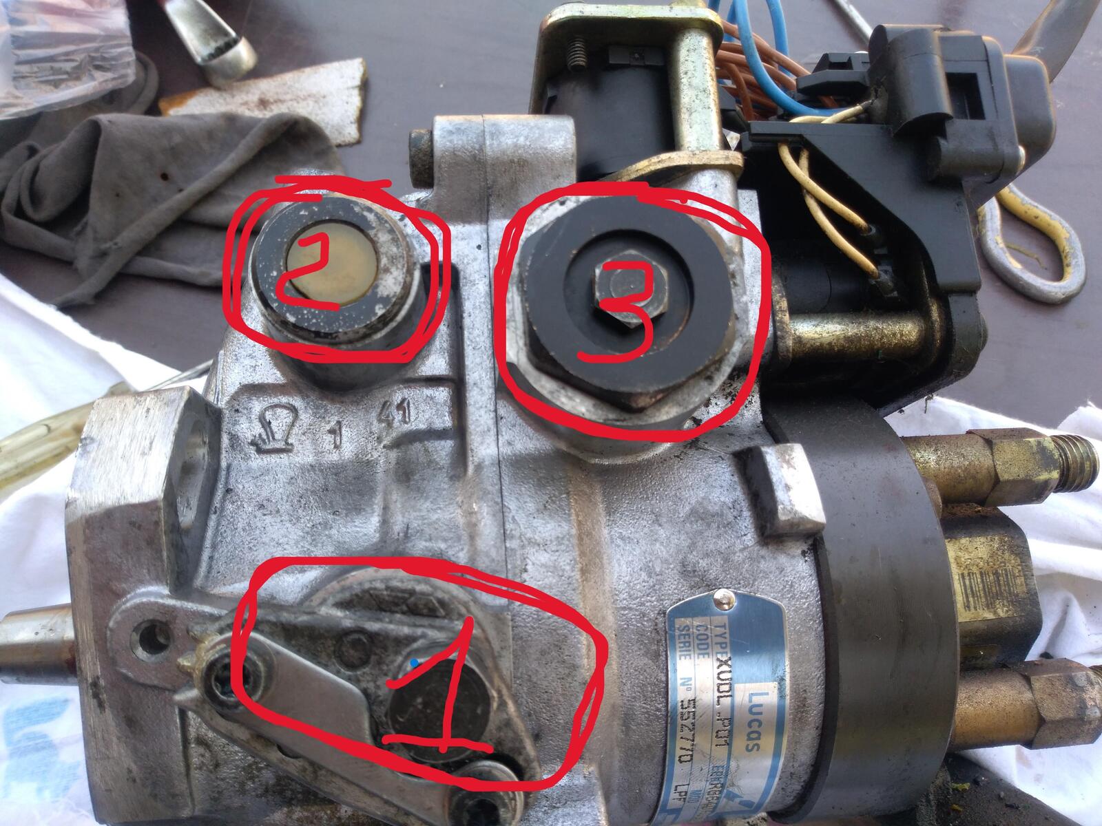

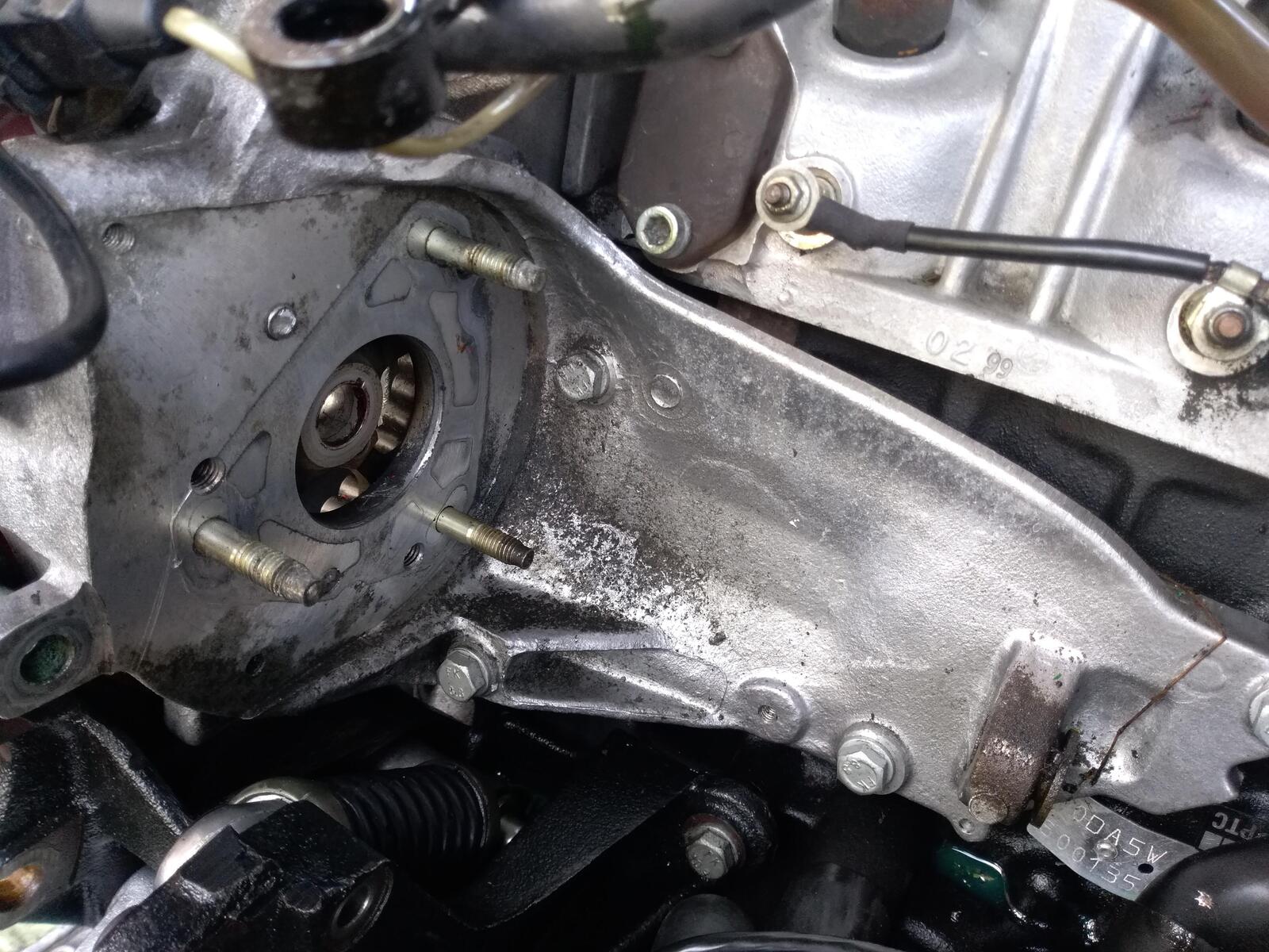

Before removing the pump, mark the place where it was mounted, so as not to move the ignition angle, later you need Lexia to adjust it.

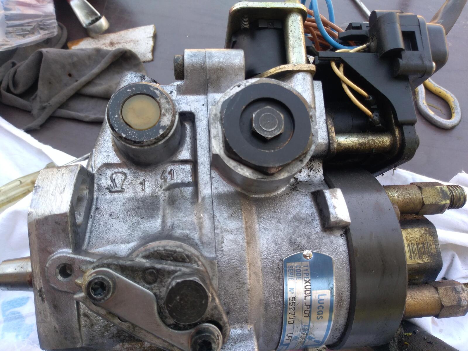

I did not change all the O-ring rubbers, I did not touch these marked places, if necessary I can replace the rubbers without removing the pump.
1. is for the ignition angle.
2. is for the pump pressure
3. is the same with the ignition angle
because I do not have Lexia I did not touch them, because after dismantling all that needs to be adjusted.

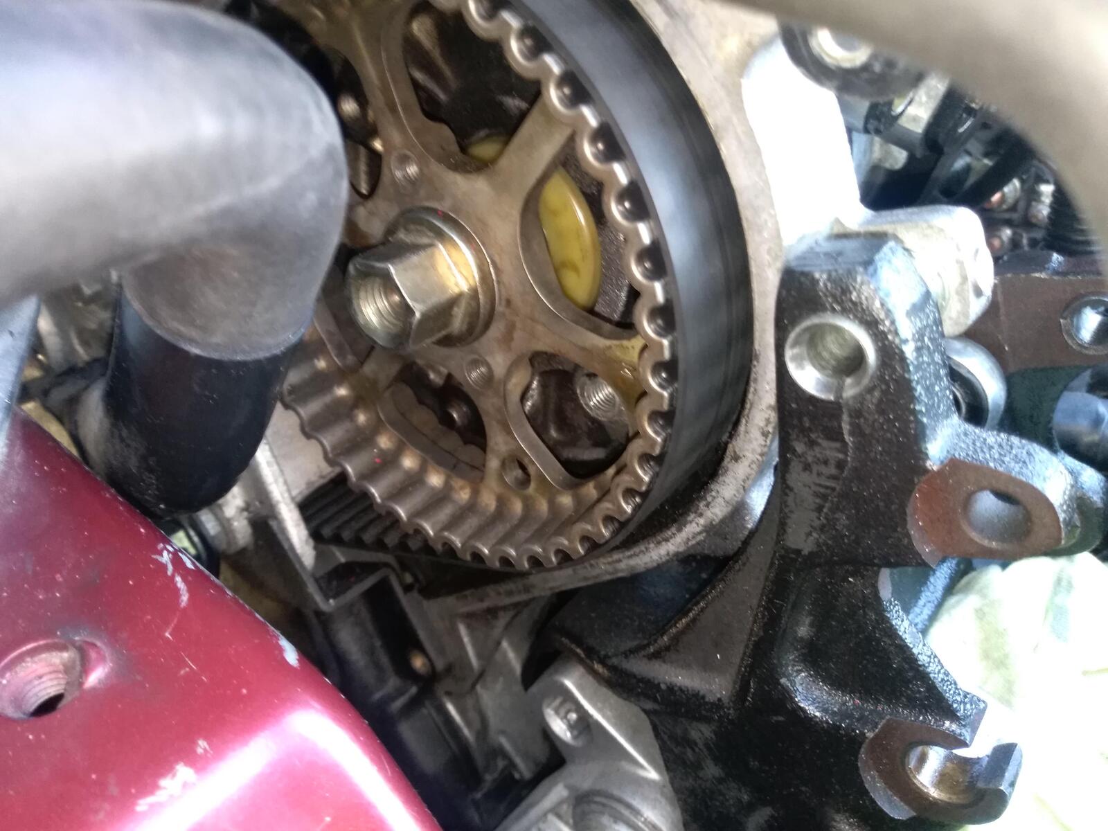

Pay attention to this part of the pump, this thicker part, marked with a red arrow, must be in this place, because that is the start of ignition. If it is in another place, it will not start, you have to disassemble everything again. Basically, take pictures of everything, mark the positions of what you disassemble so you know how it was before disassembly.

I did this on different epics some years ago. As far as I remember, you can‘t adjust really settings of the pump with lexia (e.g. in-pump-pressure). The only thing you can do, is controlling the timing, which is done static with a suitable pin, you insert in No. 1, until it slips in a corresponding hole. Then tighten the pump screws.

On the XM, there is very little space. With Lexia, you can read out the electronically adjusted timing and if need be correct the position of the pump accordingly to end up within the +/- 2° window.
